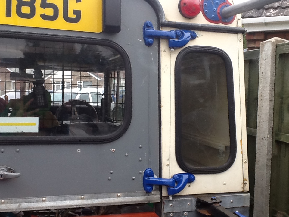

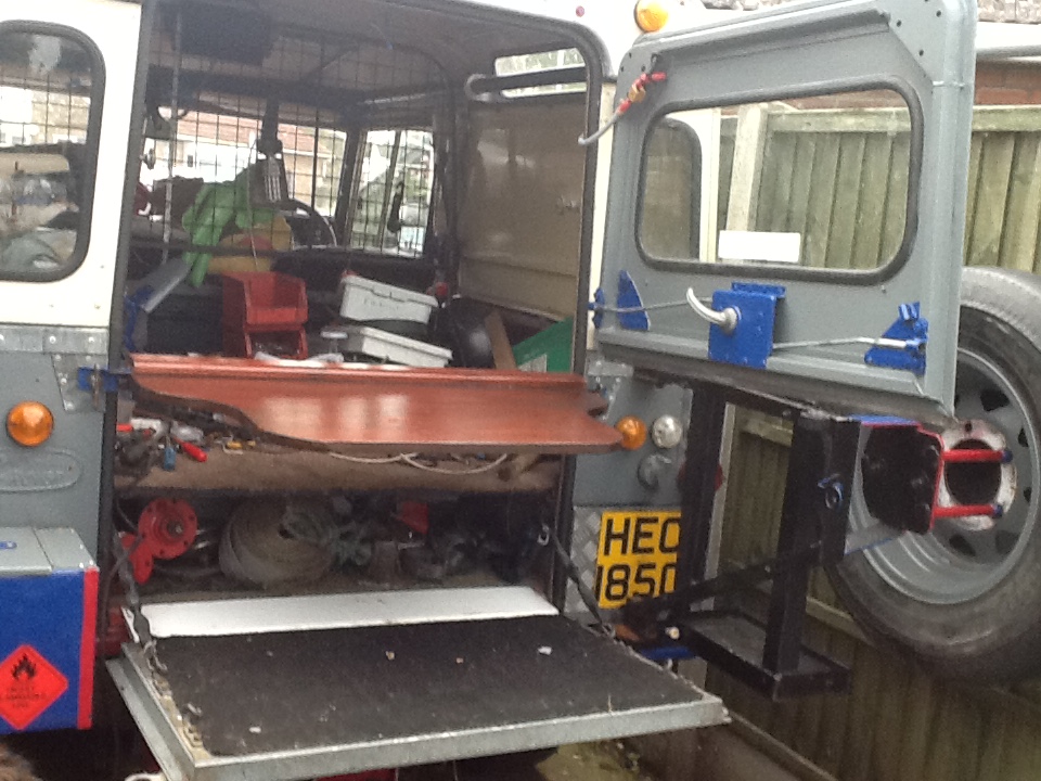

Post by romanyrose » Tue Oct 18, 2016 8:28 pm
Here you go another instalment
Re: HEC updates
Post by romanyrose » Tue Oct 18, 2016 9:21 pm
G'day chaps, i managed to tie my lass down to take some pictures of what i have been waffling on about but torrential rain threatened so i didn't rush putting the bed extension up but it works on the same principal as the table :wink: .
With the wires for the number plate lights fed into conduit off an old disco loom through the frame work of the top tailgate which is done so any rubbing when opening and shutting rub insulation off the wires i hope won't happen so no shorts i can't see will be a distant memory :whistle: .
The connecting block was used on purpose, the reason being it came out of a box of tricks that were my late fathers and were used in Cambera reconnaissance aircraft so rather than use normal bullet connectors along with some dash lights from a Shackleton Bomber were used as a reminder i guess because that's the sort of thing he did :shrug: .
I guess because my bed section is not yet painted and the screw in parts for the legs are not yet fitted it will give a reason for another picture at a later time :laugh: .
