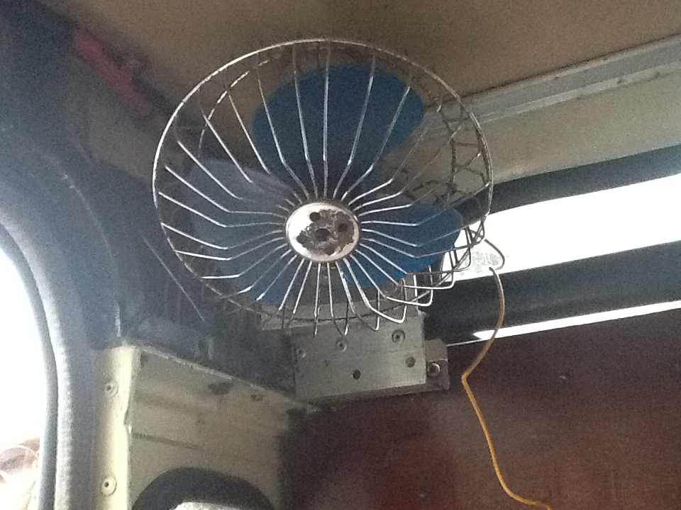

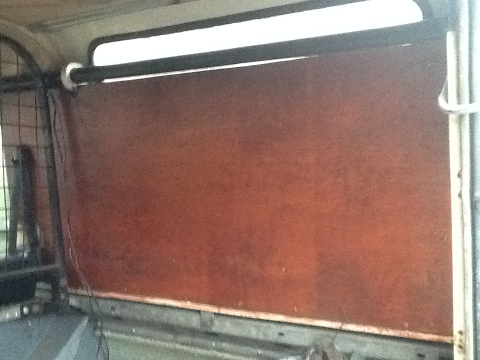

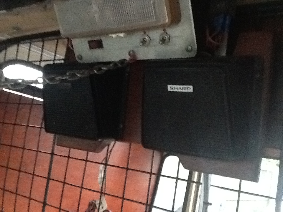

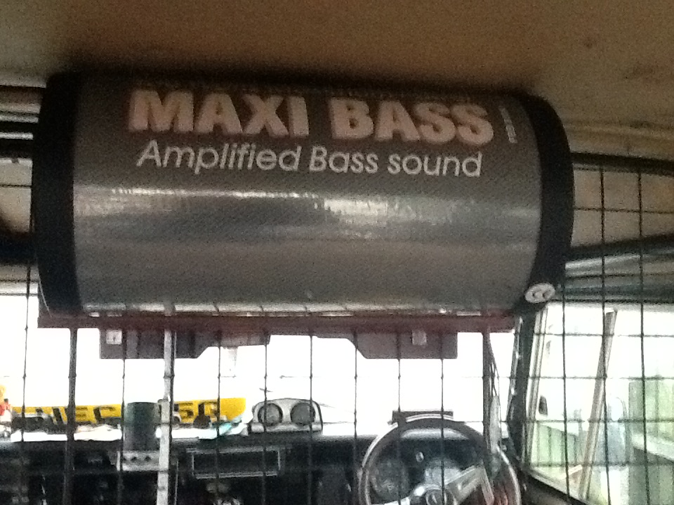

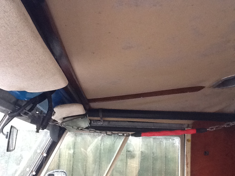

Here we go again guess what brads had me doing, my mountaineering skills are getting better but balance I've given up on.
