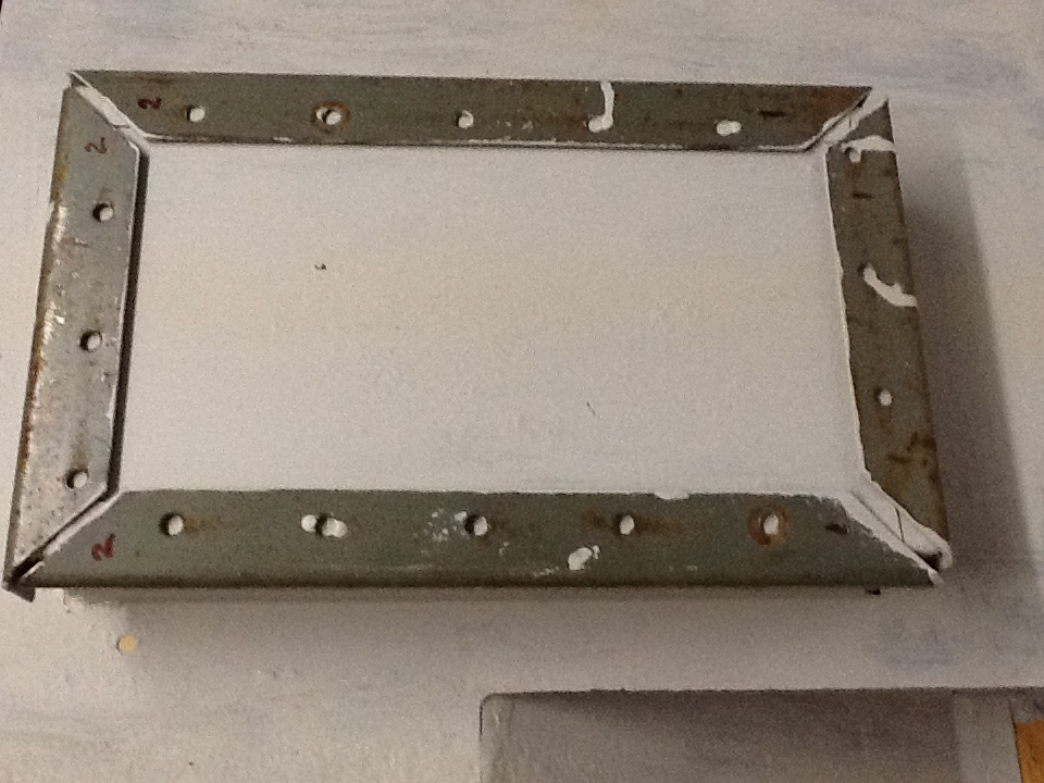

Well chap's, as usual i was not happy with the inch angle that i had cut and stuck in place round the bottom section of my battery box, thankfully i had only drilled the alloy and not the steel of the battery carrier :whistle: .
I have now dug out some dexion that is pre-drilled and wider, using this it goes well past the rusty patches that have been treated but is not as strong as the metal i am up to now. Next after confusion took over for a while i cut two long length's to go down each side of the carrier, having done that i laid my set square on the underneath section of the dexion i then marked and cut a 45 degree angle out of each end and on both sides.
Time to dig out some small nut's bolt's and washer's, of course this took longer than i hoped because they all have to be the same :embarassed: , with the dexion held in place by clamp's i dot punched and drilled the holes in the battery carrier through the existing holes of the dexion but only two each side.
By drilling the holes the size of the rivet's i will be using the small nut's and bolt's that allow a bit of slop for adjustment of the dexion front and back that i have yet to cut, unfortunately my hacksaw blade broke and i didn't have a spare :banghead: .

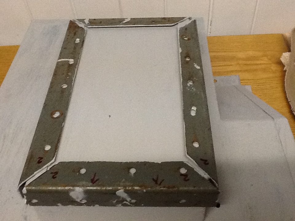

Well chap's, what do you think :whistle: , having been called a wood butcher and now a bodger, i can't understand for the life of me why :shrug: i guess because i used the word dexion they must have imagined what they would have used it for.
As i have mentioned Mr Rust has been knocked out and treated, although again as above i had made these angled part's in alloy i felt it just was not deep enough. In my mind the battery i am fitting is a heavy little tinker, the last thing i want is for it to drop out of the bottom for what ever reason and cause a short, or just leave it for someone to run over {motor cycle} and cause an accident.
To my eye's anyway the holes look as though i have drilled them at equal spacing's, however the 45 degree angled cut's proved more of a problem to my easerly confused brain :stars:, i think i have cracked it with a bit of patience a few brew's to give me confidence that i have very little of.
Because the mating surfaces are painted in anti rust paint {used on oil rig's} tomorrow i hope to fix everything in place with a type of silicone between and loosely bolt it together before riveting her up :woohoo: .
With the excess silicon that has squeezed out cleaned up i can then give it another coat of paint and go on to the next job, making a mounting bracket for fitting my Anderson female socket to that i found while looking for something else :wink: .
For those who might not know what an Anderson socket is :shrug: , it's to enable people to jump start car's off with a flat battery using only one set of large crocodile clip's if that is what you call them :embarassed: .

I had drilled a few holes for the angle to be held in place with small nut's and bolt's i thought doing one side at a time after applying the sealant to the angle it would be a doddle :laugh: , how wrong was i :banghead: i got it everywhere, to make matter's worse i got an itch on my nose scratched it without thinking :aaagh: .
In the end i marked-dot punched all the holes before drilling then debured the holes-checked everything fitted applied the mastic and stuck a rivet in with the head to the inside. Having deburd the holes meant the rivet head sat flush as did the washer fitted to the rivet on the outside of the battery box ready for my rather nifty rivet gun.
