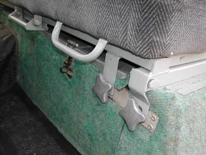

Here's a pic I found on the dormobile forum of a passenger seat , pretty sure it's a 2a conversion but is slightly different to mine. Maybe they had different makers of the seat assemblies

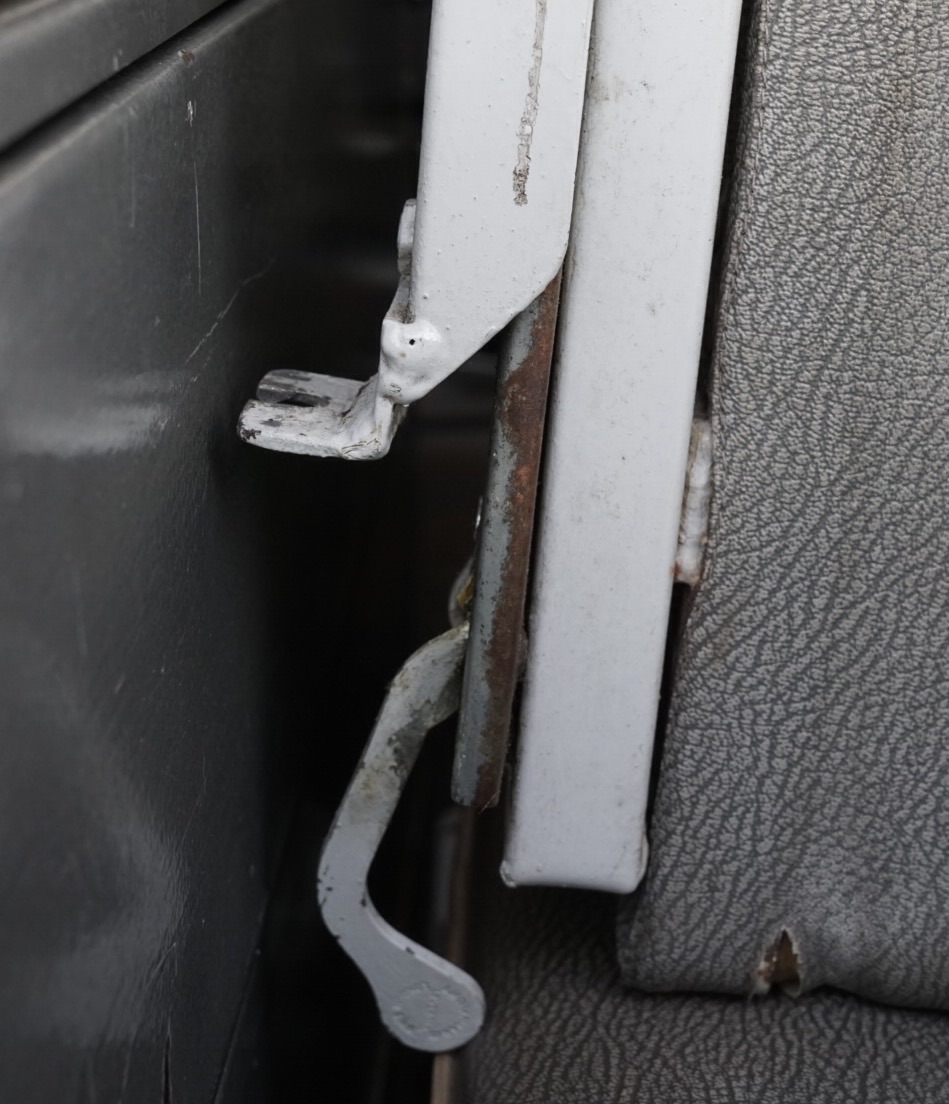

Here are the promised photos.
Bear with them as the seat is not fitted at the moment, but you will get the idea.
Hope this helps.
Hope this helps.

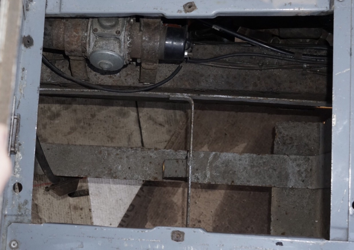

To answer the question on the issue what should below the drivers seat...
There should be a bracket assembly for the gasbottles. The hatch gives also access to the fuelpump mounted on top of the chassis rail. It fits 2 bottles.

If you take a look at the Dormobile brochure in the Technical & Workshop section, you can see a pic of a S3 with two single front seats. Maybe someone can confirm if a double front seat (and double bed) was still an option ? The current Dormobile Defender does not have the double seat/bed option and places a much bigger cubby box between the front seats.jerryd wrote:it also came with a single front passenger seat. I'll have to take a few pics of the front seat assemblies.
Your picture of the S2a seat is exactly how my Dormy's looks and I strongly suspect Colin's and Ant's.
Any chance you or Michiel could post a photo of the hinge fittings for the drivers seat ? I already feel another project coming on !

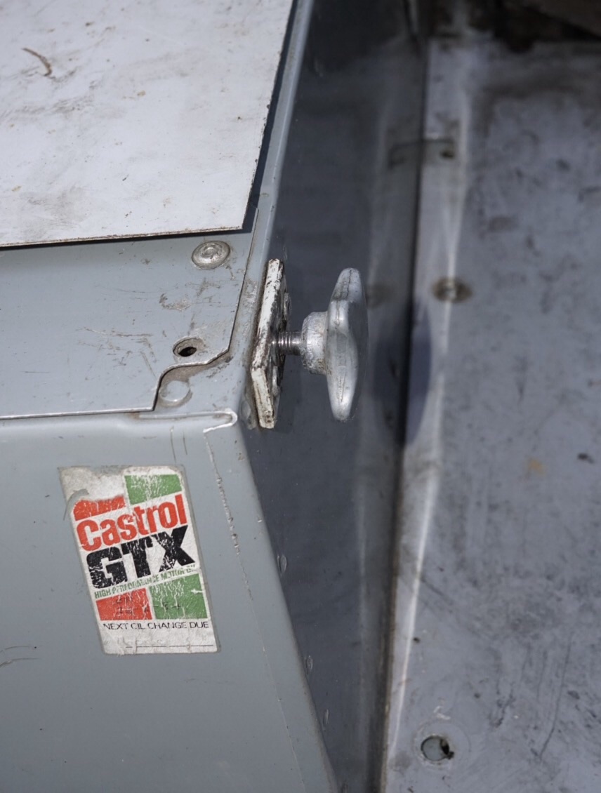

Picture below shows my seat runners.
From the colour of the bracket the runners are bolted through it looks like genuine Dormobile.
Colin

Yep, that's exactly what my Dormy's runners look like (with all the bolts).Gromit wrote:Picture below shows my seat runners.
