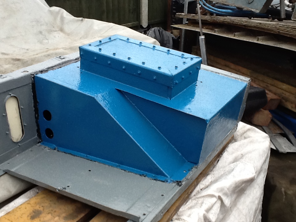

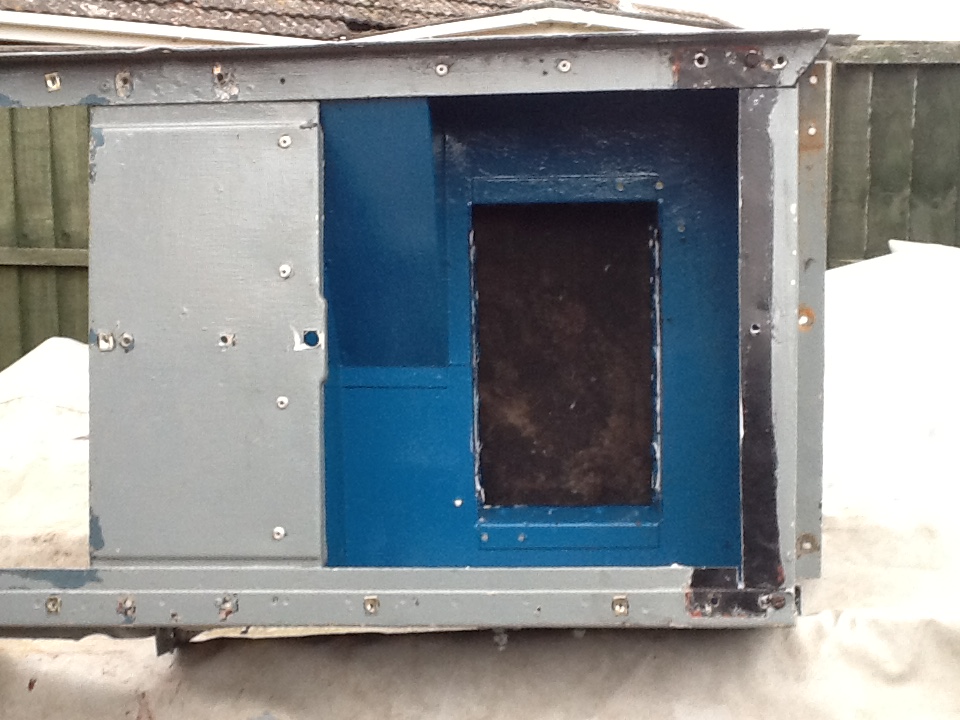

The now finished seat box was turned upside down and given to coat's of etching primer/undercoat, of course me being me the now solid battery carrier had it's final top coat of Leyland light blue that although i say so myself now look's solid and colorful.
I will get my lass to put up a few picture's as soon as i can, the reason being i guess is because the battery box/seat box has come out better than i thought with no welding just a it of precision guess work :wink: and of course patience :nana: .

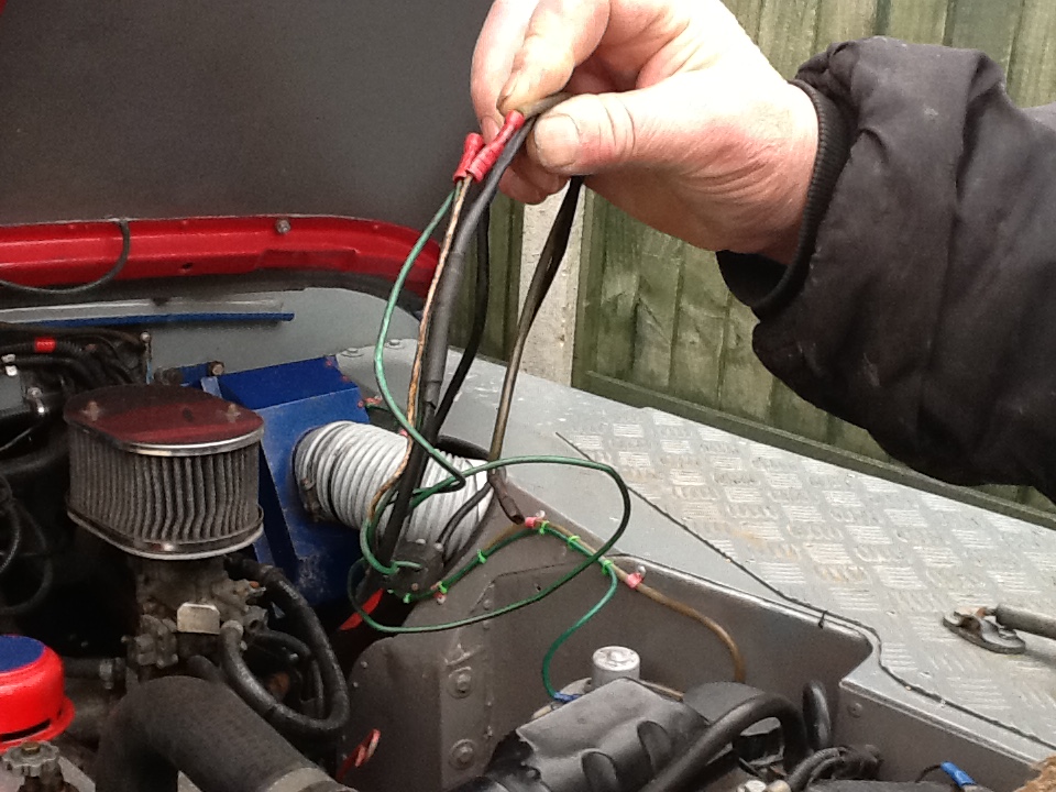

Hey up chap's,Unfortunately the weather was not on my side today but i did manage a little something all be it in the clean electrical shed. To make sure i had enough of everything it was a case of going out and checking what i needed to make a neat job.
The wind was howling a tad to much for me to solder out in the open air, the fact i would be kneeling at some point or stood on my soap box to reach down deep in the engine bay, i thought it best left for another day.
I did however have a good inspection nearer to where the loom goes into the chassis :aaagh: , the picture of what i have in my hand was part of the loom :banghead: . Although i am not one for originality as you might have noticed, the fact i love colour that again you might have noticed :whistle: , bodged wiring is one of my pet hates so you can imagine the horror on my face and in my thought's when i pulled that little lot out :thud: .
I have now got to think what my next step is, i can solder the bullets on the loom nearest to the chassis but think i have to pull the loom that is in the chassis out from the back end :rant: at one's self. I know at the back of the truck the loom is in a proper box, his mean's i guess i can pull it through just incase welding to the chassis in the past has done any damage :shrug:, better to be safe than sorry i guess. Knowing me and my bounce while asleep the situation will be blown out of proportion as per usual, so i guess that job is another that has to be sorted.

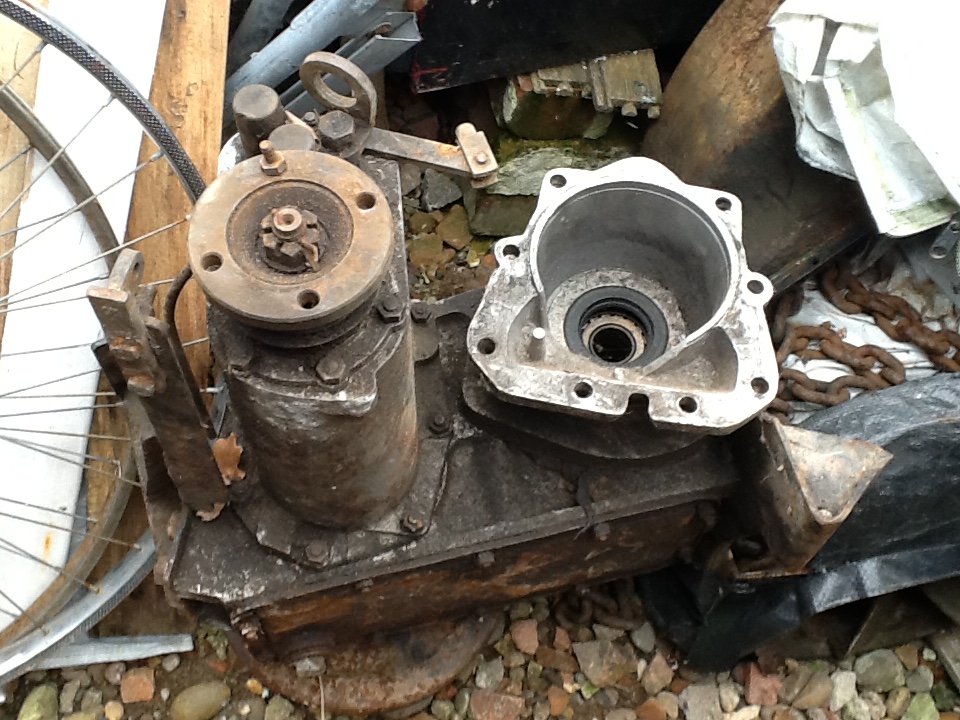

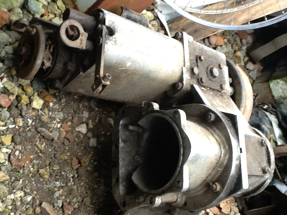

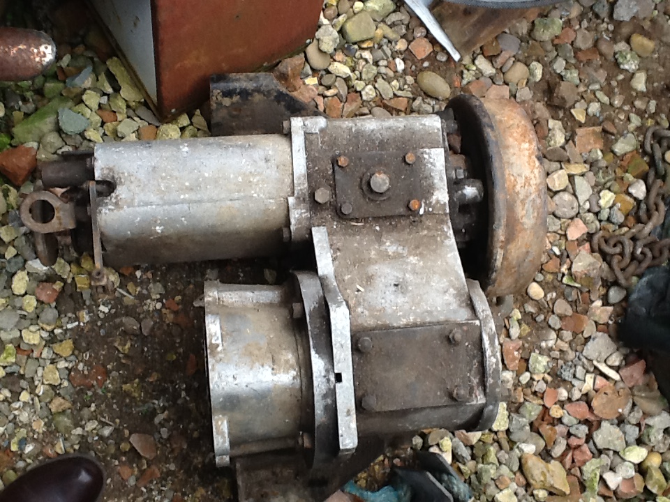

G'day chap's, i had asked my lass to put these on the forum but forgot to say where :embarassed: , to be honest i need to know more about the kit, although i can tell you they are from an 88 and could be a Borg Warner 66.
The reason i said they, is it is a high ratio transfer box, the conversion part i think is for an automatic box but what i do know is low ratio is a standard bit of kit.
Once identified it could be for sale or swop :wink: , but if i manage to come across what i might need to use this bit of kit and fund's are available HEC could be an auto just to be different.
Robin or Patrick please feel free to do as you think fit :shrug: .
