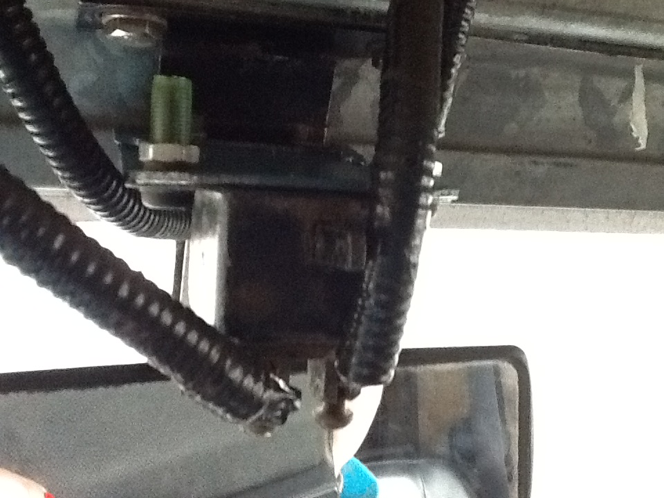

Gday chaps, after a long timeof waffking on about my wires and the fitting of relays i finally got my pull switch wired up using a series two choke switch as the picture at last shows :nana1:
Maybe not to everyones taste but as you know tinkering i reckon should be my middle name but at last i am satified with my wiring that as most owners know get bodged beyound believe and when adding extra's it's not long before the old wires and switches either burn out or just stop working :thud: .
