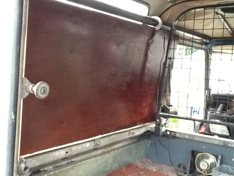

HEC update as can be seen is the n/s back panel finally fitted which is stained come varnished and ready for the next step, regard's the garden furniture it was free so i cleaned it up and gave it some paint and my lass is a very happy Bunny which is all that matter's to me

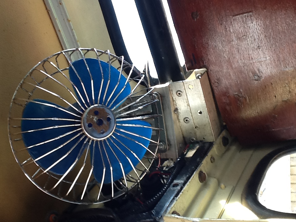

Anyway while planning my next job i remembered i had laid down an extra wire in the loom to the back body for a fan to keep my dog cool when caught up in stationary traffic so i set to with a plan of making a mounting bracket that would be bolted to the rib where the roof is bolted to the side but using riv-nuts in the horizontal position in the vertical lip of galvanized steel.

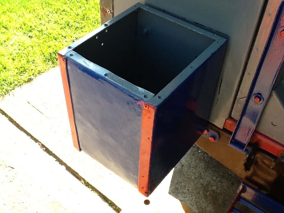

The gas bottle box has had a trial fitting and has now been etch primed-undercoated and one top coat so at least i have achieved a small job today.

While the paint was drying i dug out my riv-nut tool with assorted riv-nuts which i can of get carried away with but luckily i had plenty of the smaller size so having drilled out the small rivets previously all i had to do was enlarge the holes in the box so the riv-nut sits nice and snug then compress
Although it seems a simple job to some i was really pleased everything went well and all that's left to do tomorrow is paint the top then that's another step towards starting on the cooker mount that i have deliberately not done until i have been on a bit of a road trip with girly to pick up a load of trinkets that i am told might have some cooker parts i am after from my Bud Matt

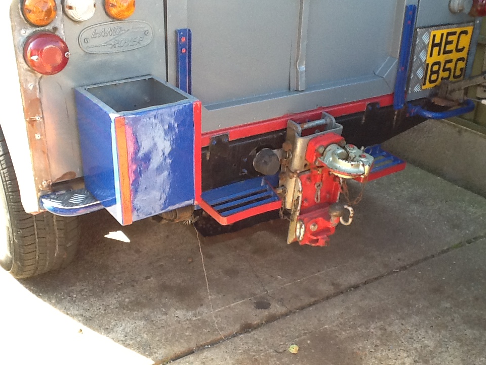

Well this week well two,has been all about brackets and boxes.
Here's some pics for you to see.
Brad will talk more later.
