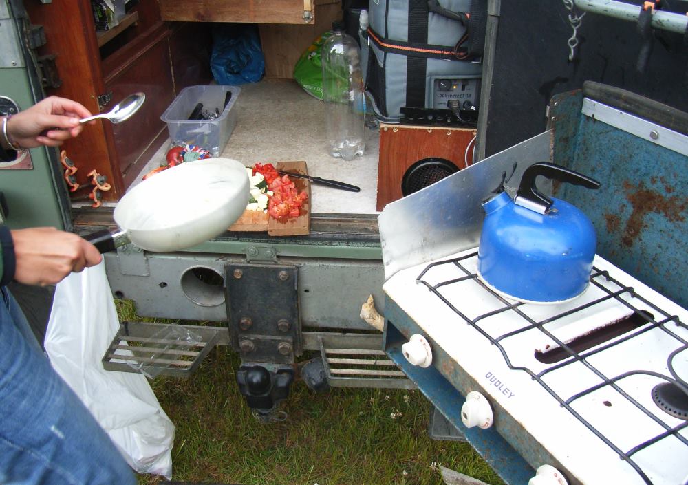

You probably remember it in detail already Mick, but this is mine, far as I know it's original, and folds up against the back door when not in use.
Just high enough to be able to be used inside if necessary, though it's only an inch off the floor.
The side panels were something Dad added, as the breeze tends to affect the flame a lot the side protection helps. They live under the grill and slot in when necessary.
NPF554L cooker
NPF554L cooker
(Taken from a trip to Scotland when we forgot the chopping board and table legs...)
