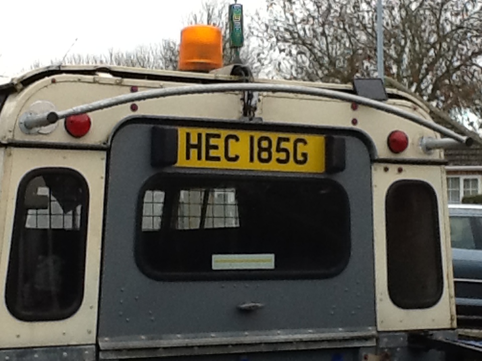

G'day chaps, well i had a visit today from a member of this forum who had seen i had a few problems with the understanding of the fitting of the pull out canopy on the rear of my 88 :embarassed: even though he was on holiday he trundled over in his 109 and after a brew promptly set to and took off parts on the rear of the truck that were in the way although they will be fitted in a slightly different place probably tomorrow :shrug: .
Luckily the weather was kind to us and in his T shirt he set to measuring up my rear end marked it up dot punched the marks and with the relevant drills and hole cutters set to and did what needed to be done encountering a few issue's but they can be easerly solved by me and my bit of tinkering :wink: .
Because i have a headlining in the cab part of my roof the brackets for the lining will have to be lifted a tad so the tubes that the canopy are level and not forced downwards which makes the sliding of the frame work a tad on the stiff side which might eventually ware through {Simon ''Woolen on the forum'' } does not have a lining in the cab of his safari roof that was the difference to mine but like i said will easerly be rectified.
My top tailgate has the number plate stuck to it also a YUGO number plate light each side so the tailgate will not open until the canopy is pulled away from the roof a tad so i will make it so the position i can open the tailgate will correspond to how far the canopy is pushed in that will be permanent but a picture at a later date will help one understand :whistle: .

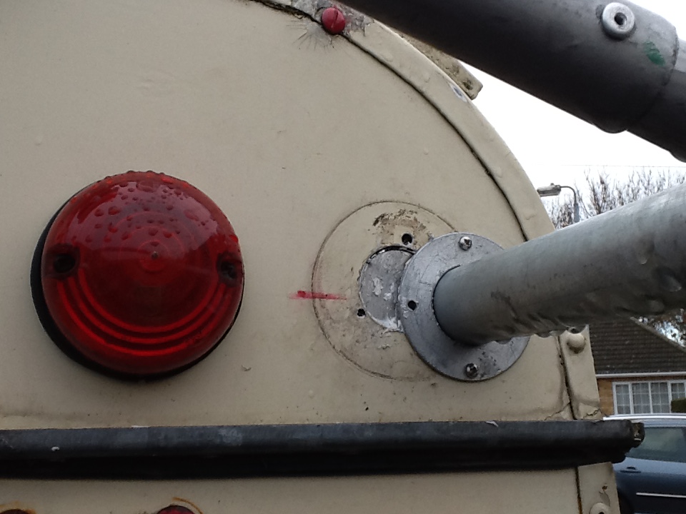

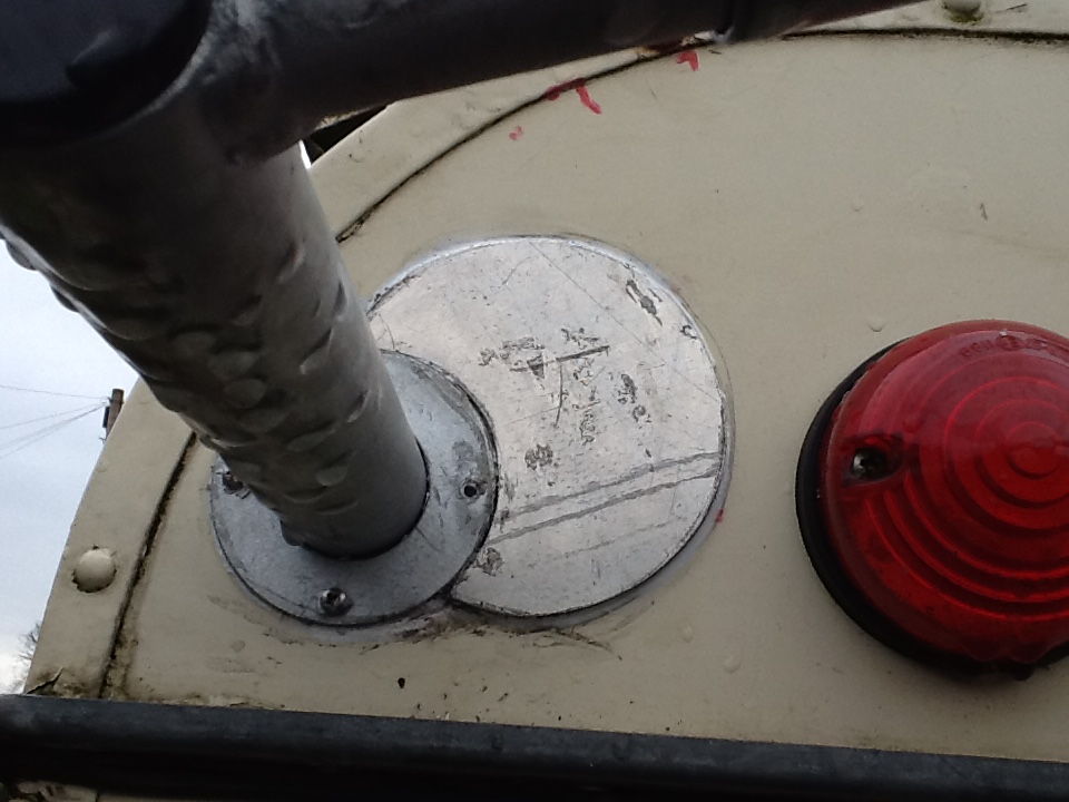

G'day chaps, having spent a good part of yesterday in my bed trying to warm the bottom part of my back to help with the discomfort of standing a lot the previous day it was back to tinkering with the making of two round alloy plates the size of a light fitting that Simon had to take off because it was in the way of the side poles of my new canopy.
Of course i have extra lights indicators and work light that were in the way and although Simon worked fast in a T shirt he was very careful and now i am making fillets for where the indicators on the top corner each side were mounted i then set to and made only one up till now semi circular plate that cover where the top indicator was situated.
I will be fitting everything back where it was prior to when the work was started but in a place that it does not interfere with my canopy basically because what was there was put there for a reason so why change it but then tinkering with angles and odd ball things is done because i enjoy doing something different :laugh: .
Tomorrow if it stays warm and dry i hope to finish the rear end of HEC and her new canopy thanks to Robin for knocking them up and like i mentioned Simon for coming over from his holiday at the sea side to install it a lot quicker than i could just thinking about it :whistle:

Here is the photos i have taken today, at last the rear canopy is fitted, not straight forward but then thats brad wanting his way.

G'day chaps, now back on my old faithful computer i can explain what was done and why but i guess it's easy to see that my top indicators have gone and what i have had to do to have the best of both worlds so to speak but fear not the indicators are just being fitted in a different place :whistle: .
The bracket that held my rear work light has had the center cut out so as to make provision for the center pole of the canopy so hopefully all being well tomorrow that will all go back on and i will be back to where i was before Simon started the job bless him :cheers: .
