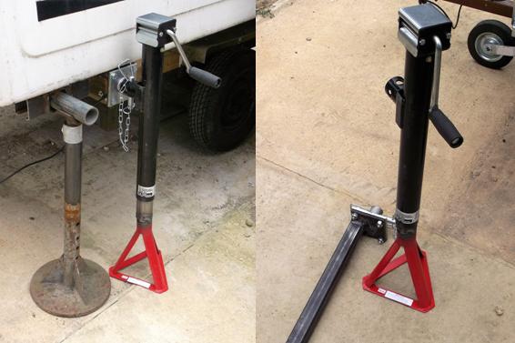

Actually lifting to height will not be a problem.
Stability during the lift may be. As you lift one end, the pod will go off horizontal, which tends to push the jacks at the other end off vertical .... probably similar to using a Farm Hi-lift jack with only two tyres touching the ground on a windy day.

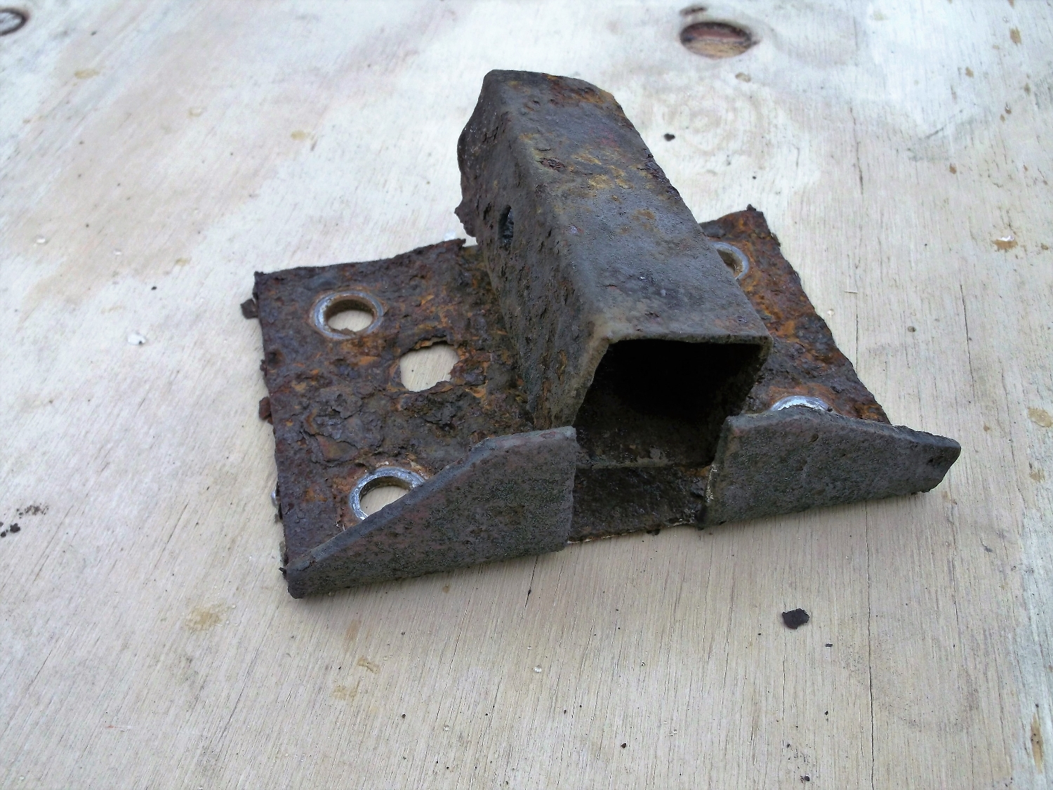

I'll see if I can find a photo of my modified jacks. Yes. They are straighter than the photo suggests. The other photo is of an original jacking point ...I think a PO had an "Oops" moment.
Instead of the two little jacking points, which seemed somewhat less than adequate, I have fitted 50x50x4mm thick box sections across the full width of the pod, and modified the jack probes with 40x40x4mm box section welded to the detachable flanges. This leave a slight rock, which relies on wide feet to compensate. Probes are at 600mm above the ground, and can lift 400mm. The jacking points add a further 50mm to the clearance above the tyres. That should be adequate, or even over-kill, but we all know what Sod's Law says.
