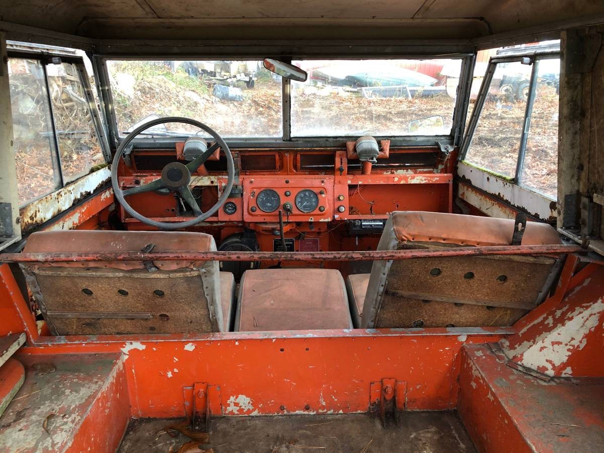

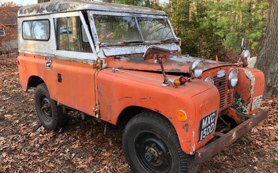

I am the new owner of a solid Searle 88 project. Vin starts with a 244 suggesting original LHD petrol and the C suffix dating it around 66/67.
Not much Safari accessories with the exception of the front seats. Hopeful that I can get enough information from the group to recreate at a minimum the rear seats, with the intention of actually hitting the road with it in a few years.

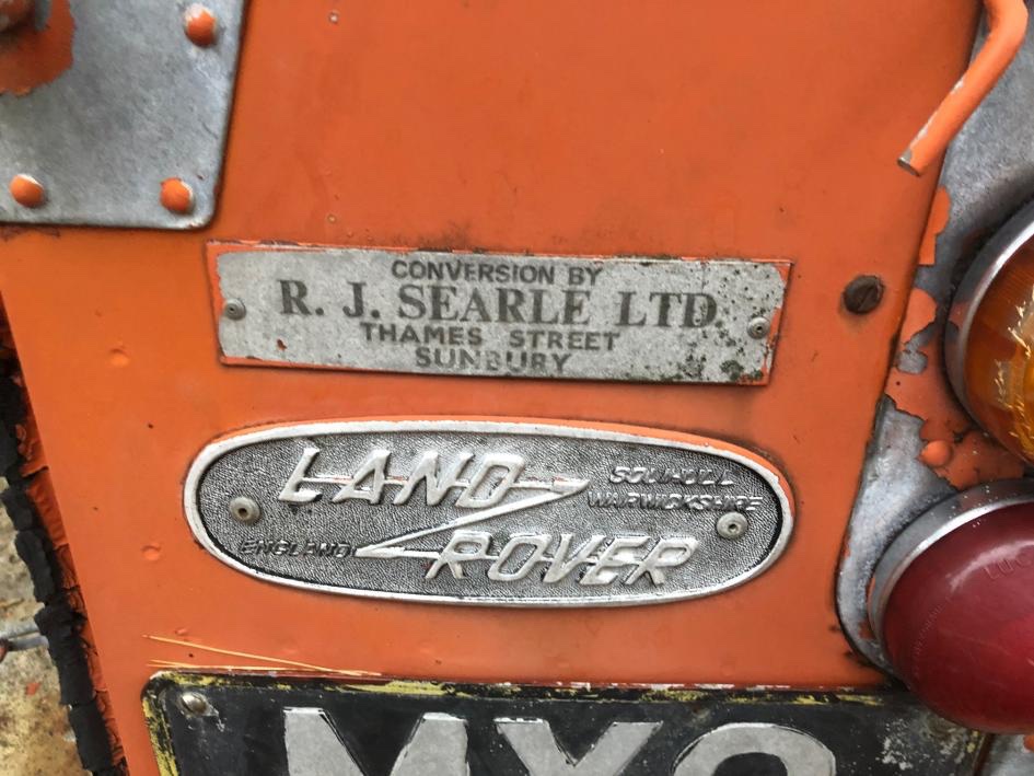

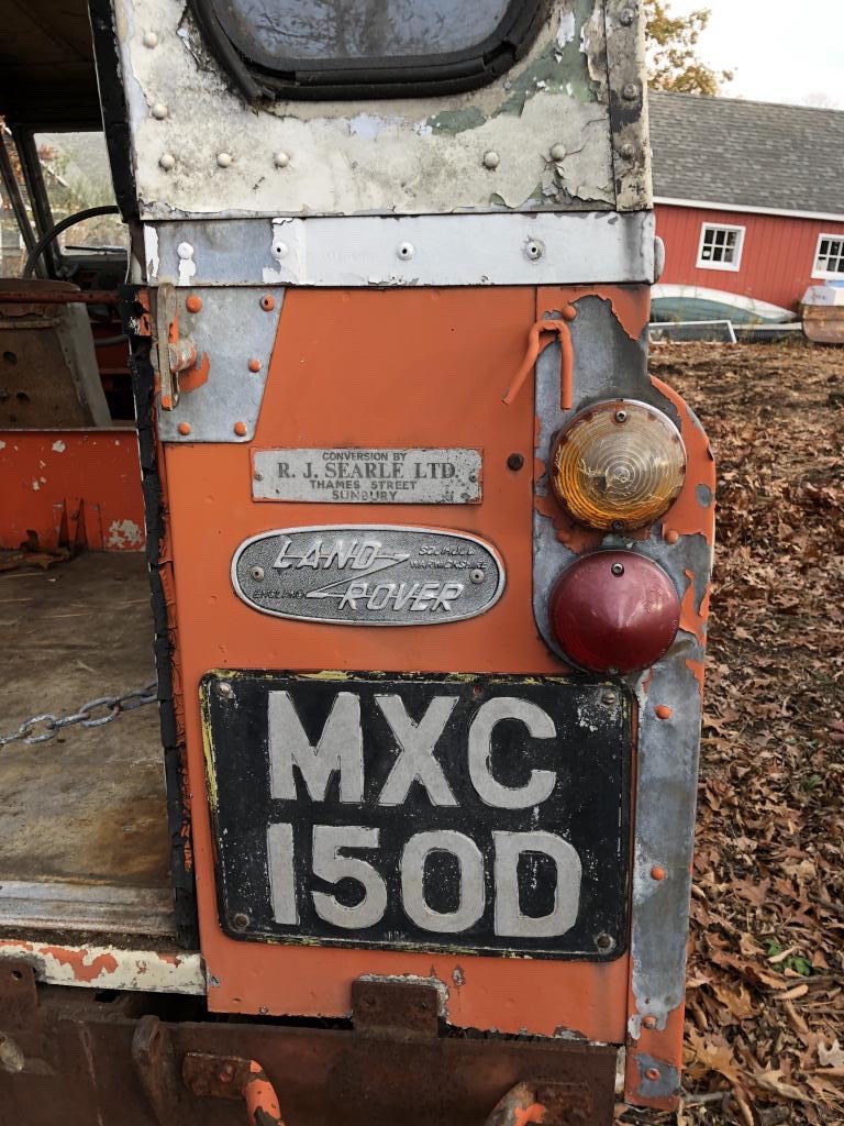

Intersting sidenote is the UK tag; wondering if anyone knows anything about it, or can point me to a source of information to try and understand if it spent some time in the UK. Maybe from elsewhere in Europe originally?

I'm not sure there will be a lot missing, apart from the seats and possibly a table :shrug:
The rear windows have probably been added by a previous owner - I think the Safari usually had van sides.

That registration doesn't come up on the UK DVLA database, so was probably exported before the records were computerised.
There is a process for trying to get historic info from the DVLA, but it's very restricted now due to GDPR (privacy) which tightened things up a year or so ago!
However, we do know that the registration area of XC (as in MXC) between 1964 and 1974 was Solihull, so might even have been factory registered :shrug:

Oh, and the repositioned front sidelights and indicators could have meant it had Jerry cans fitted in front of the wings.
Are the lights on top of the wings headlights (ie. dip & full beam)? If they are I wonder if that was a local regulation for the positioning of lights - that's one of the reasons LR moved the headlights to the wings on later vehicles, for the USA market :tiphat:

It is indeed a Searle Safari and going on the British registration plate looks like the second oldest that I am aware of.
Due to the anti luce locks on the back I wonder if it was fitted with a tailgate and catflap?
Lots of the missing / damaged parts are normal Land Rover items so should be no problem in getting those found.
However the ‘bed’ is missing, which makes these motors what they are, but nothing is unsurmountable just depends on how much time, energy and cash you have!
Good find and thank you for sharing :nana1:
