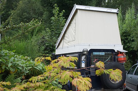

Thought some of you might be interested in my home-made lifting roof project. It's on my 25 yr old 110 (it's an '89 Hard Top retro-fitted with a 200Tdi):

Gave it some more thought and then realized I should just leave the existing roof intact, and build up out of the existing gutter line. Then bolt the 'new' roof to the curve of the old roof at the sides, and bolt through the alloy front and back, and fabricate a lifting mechanism above that on clean straight lines - ie not having to worry about curves at back door and windscreen.

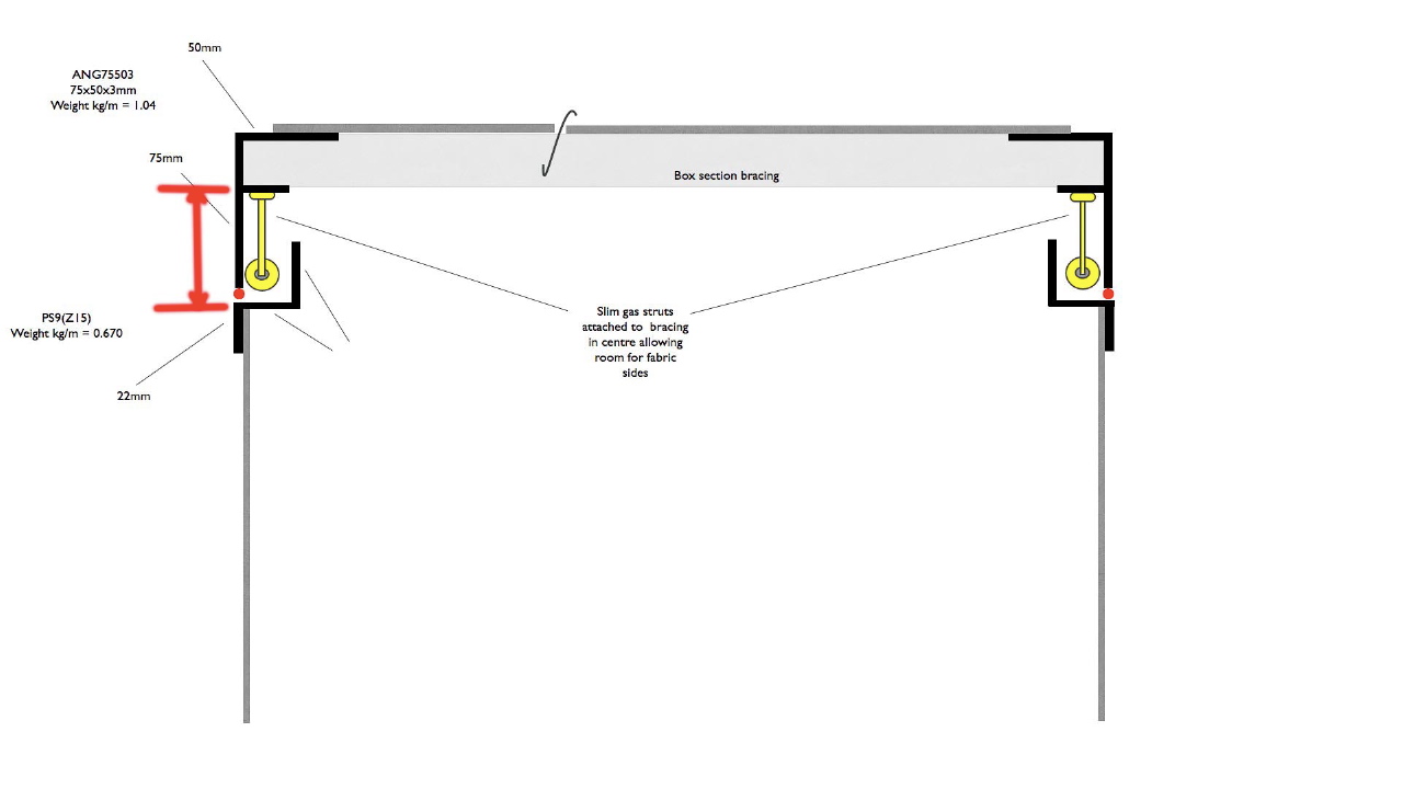

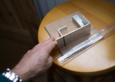

I did a wander around the web and eventually found two easily available alloy extrusions that would allow the roof to work - one a Z section that gives a water-resistent upstand to use for the lower section, and the other a long L section to use as the lifting bit. Crucially the combination of these two sections together leaves enough space between their vertical faces to allow the fabric sides to pull inside when closed. The various early drawing are below - the design 'evolved' considerably as it progressed so things like the roof attachment and roof rack design are different in the final version.
Now, so you could see what went on I tried to duplicate the build thread which I've been maintaining on Expedition Portal, and cross-post to here, but although ALL my images are hosted elsewhere a lot are 1400px wide and this forum only accepts 1270px or so which would mean me re-sizing ALL the hundreds of images I've uploaded (and trying to keep the same filenames), or reposting another set at reduced size. I've not really got the appetite nor the time for either at the moment. So......I'll show you what I started with - a couple of pieces of alloy and an idea and where it finished up:

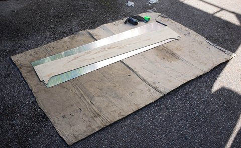

Bought some sheets and had it sliced:

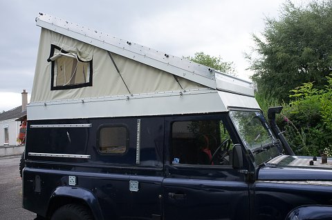

And exactly 1 year later (virtually to the day - started last July, got the fabric on this July) I got the thing fabric sided and working:
I've still got a load to do - more electrical work, small kitchen details, back door stays, a rear awning to be sewn up, and at least a dozen other things, and I've designed it so that I can instal hard sides made from Dibond alloy sheets (bought them last week, scratched so reduced price) and the idea is that they can be clipped in easily in grotty conditions/winter use.
The Exped Portal thread is http://www.expeditionportal.com/forum/t ... f-on-a-110, all 42 pages of it, but I'm happy to post updates here and if anyone has any questions I'm happy to oblige with answers if I can.
Build cost thus far - just for the buying and fabrication of the alloy sheet & extrusions, and various bits like gas struts, stainless hinge, seals, roof hatch (yacht fitment) and excluding lights, fridge, etc is about £1200. I did some welding myself on the steel bits but the alloy welding on the corners was done by the local alloy boys (and they did the folding of the front angled piece above the windscreen using a template I supplied) and they got paid. Fabric was cut and sewn by local tentmaker/tarpaulin maker and they got paid, but all the rest was my own labour. I would have done the sewing but wanted to save time. I didn't scrimp on stuff either, so Sikaflex and similar was used, also quality rivets, good stainless fastenings where appropriate etc. SO if you wanted to save money you could buy cheaper fittings, non-stainless hinge, avoid the roof hatch etc and cut the cost.

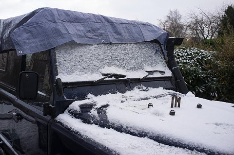

It was on my drive from July until December working in these condition (north of Scotland):

- Side panels and bug netting opened.
- attachment-3.jpg (37.81 KiB) Viewed 11748 times

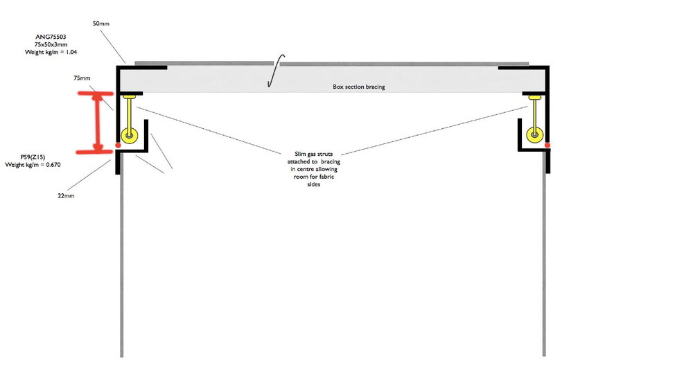

And here's one of the drawings I forgot to add above:
